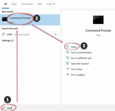

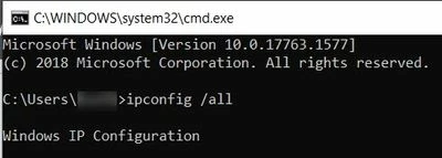

Please refer below three options:
  • Click Start > Run > type cmd > OK
  • Run Windows command ipconfig /all
Computer's physical address is value of "Physical address" field under "Ethernet Adapter Local Area Connection"

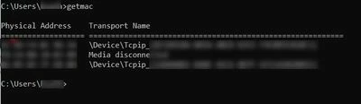

  • Type getmac
  • Physical address get listed

  • Open Command Prompt (using Run command cmd)
