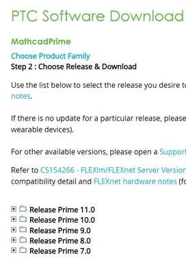

How do I install the XMCD/MCD converter on PTC Mathcad Prime 10? Is the only way to uninstall and reinstall Mathcad and select the extension? This is on a work computer so is there any other way to install it without doing that?
Best answer by ppal_255687
PTC Software Download - MathcadPrime and then download your release.
Run the installer and follow the instructions. You can add on the missing feature. No need to uninstall.
