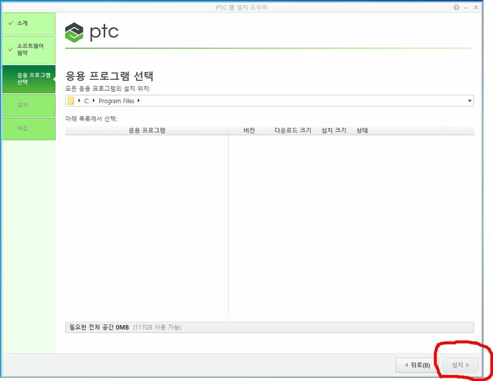

I can't move on to next step.
  • February 1, 2021
  • 789 views
there is nothing when I am installing this application.

Hi @김일_9733165
1) Try running setup.exe using Right Click Menu option "Run as Administrator" OR execute the setup.exe from an Administrator command prompt window.
2) Try creating a new folder "mathcad" in Program files folder and set the installation destination folder to the mathcad folder created.
Seshu
