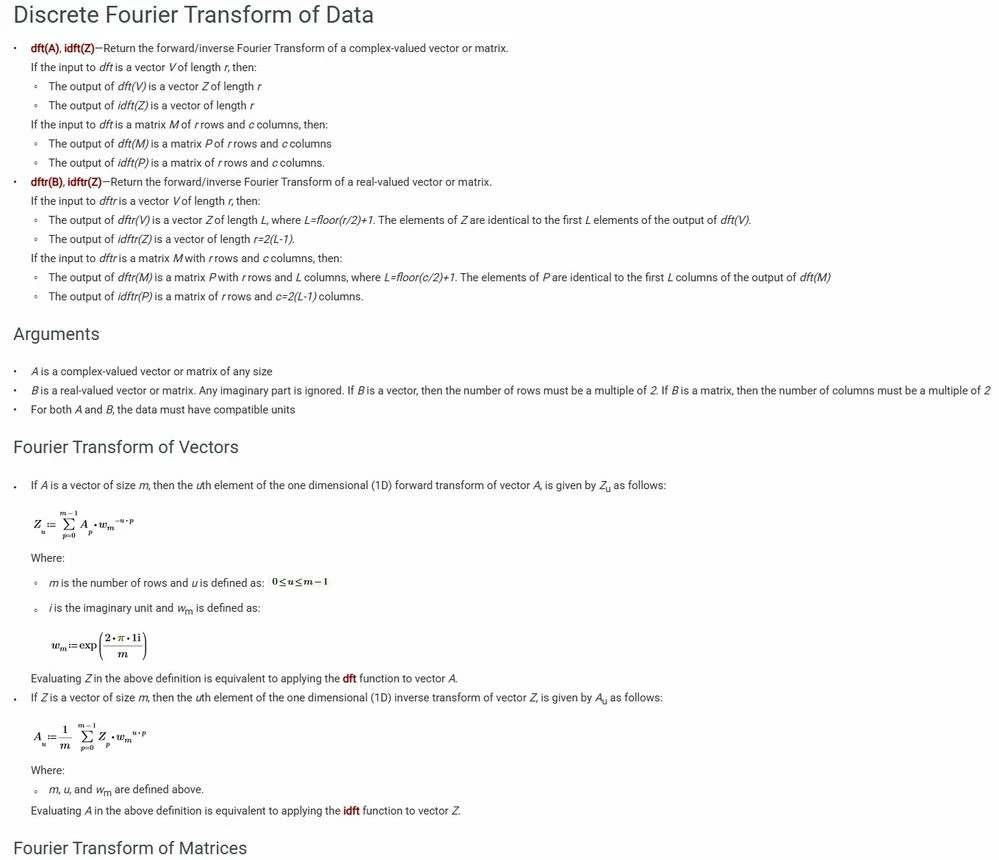

I need to do the Fourier transform calculations.
January 29, 2025
From the help files:
