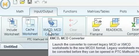

I am using Mathcad Prime 6.0 6.0.0.0
how to do i bring in .mcd into 6?
Best answer by VipulT
Hi @CA_9541895,
Mathcad 15 supports native formats *.xmcd, *.xmcdz, *.mcd (Worksheet) cannot be opened directly in Mathcad Prime
XMCD MCDX converter can be used to convert legacy files. To enable XMCD MCDX converter Mathcad 15 is necessary to be installed on the same machine up to Mathcad Prime 6
Wherein PTC Mathcad Prime 7.0.0.0 provides a standalone legacy worksheet converter that can be installed alongside the application and does not require any legacy version of Mathcad 15 to be installed to use the converter.
Vipul

You need to convert the file to the Prime format.
Cheers
Terry

Hi @CA_9541895,
Vipul
