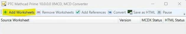

Dear all, good afternoon from Brazil. I hope you are well. Since our Mathcad´s Brazil support team did not solve our issue, which is a big problem for us, we are contacting PTC directly. We have 7 Mathcad M15 M045 licenses (one of which is a network license) acquired by General Electric in recent years. In the last few weeks, we bought one more standalone license, but it is for PTC Mathcad Prime 6, because it is no longer possible to buy an M15 license. Our problem is that the Prime version does not directly open the M15 files of our current version. To do this, we were instructed to do a conversion from the old format of the file to the new format. But here is the problem: after this conversion, a lot of information, formatting and macros are lost from our worksheets and the calculation is not done directly without first solving some problems. So that you understand the seriousness of this problem: we have more than 200 folders, each of which contains between 25 – 30 Mathcad worksheets that we would have to fix in case this problem persists. Basically, it represents a lot of time to invest in this problem that is not caused by us.

Here is the good news the converter can convert large numbers of files at once.  I assume the 200 directories with 25-30 files per directory is in a heirachal directory structure with a top directory..
Open the converter and select "Add Worksheets"

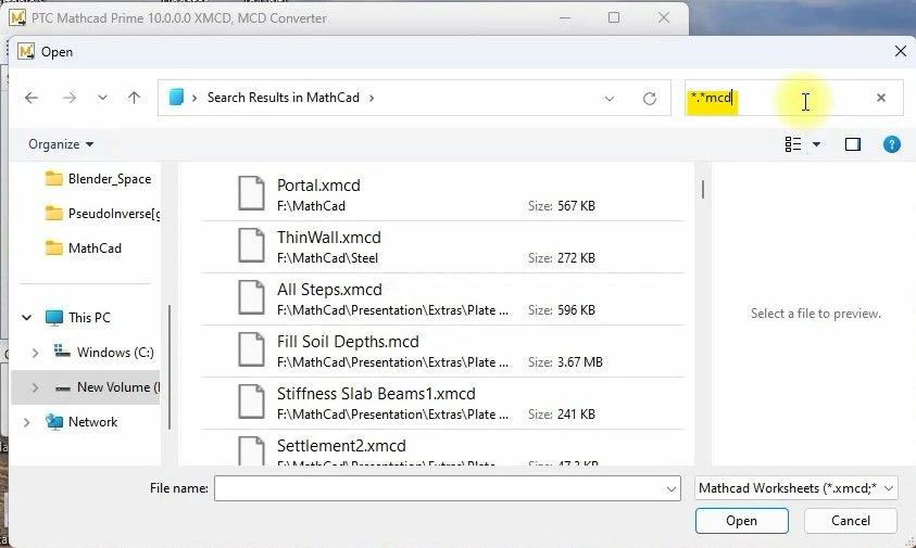

In the windows open file dialog that opens use a search criteria of *.*mcd from the top of the relevant directory tree.

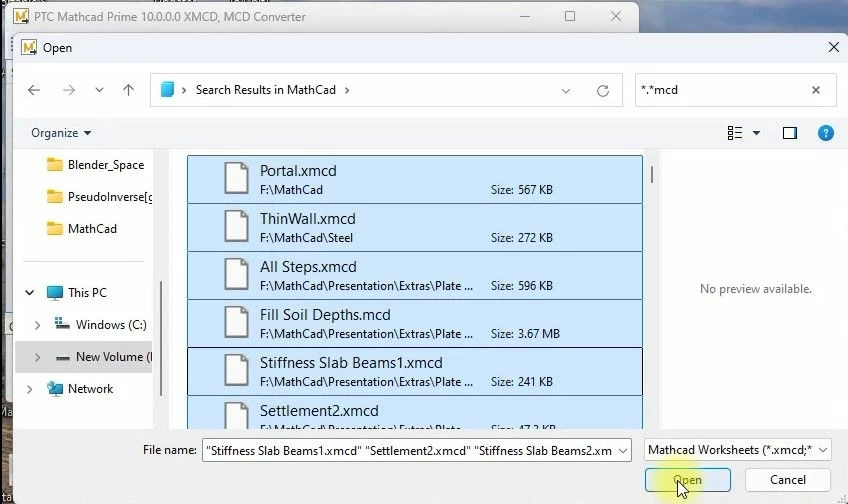

Now use Ctrl + A to select all the files in all the directories.  Once all selected press Open. This will work across the network and spills through all subdirectories  at once.

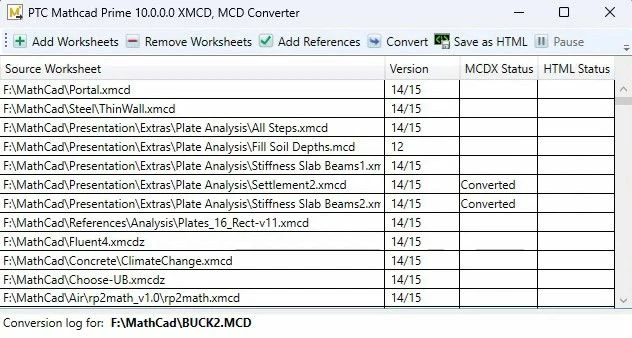

This will get all the files at once into the converter dialog.  I do not know the limit of the number of files allowed.
Then it converts one by one when the "Convert" button is pressed
Now it is necessary as you use the sheets to manually adjust the layout and reprogram any programmable controls like check boxes,
