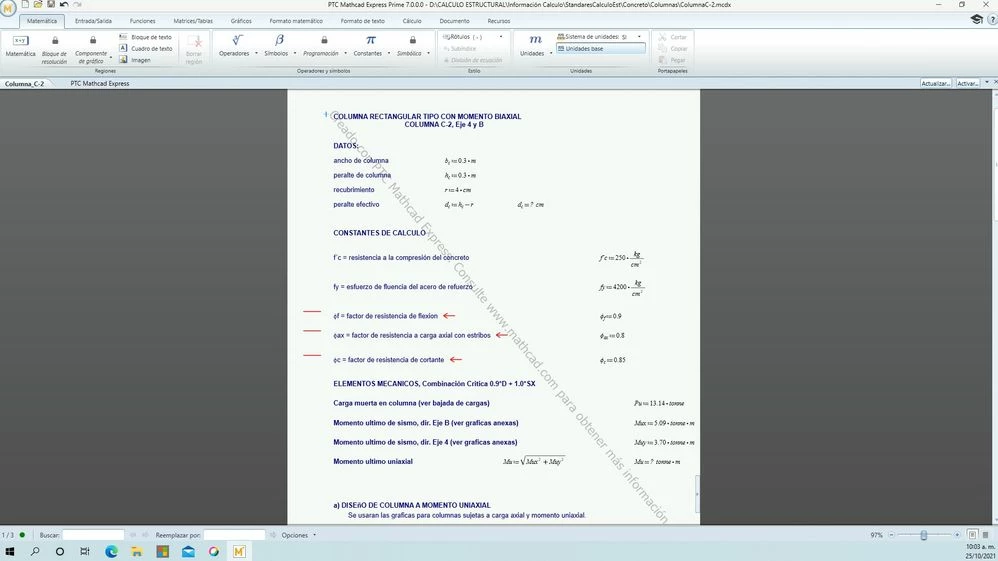

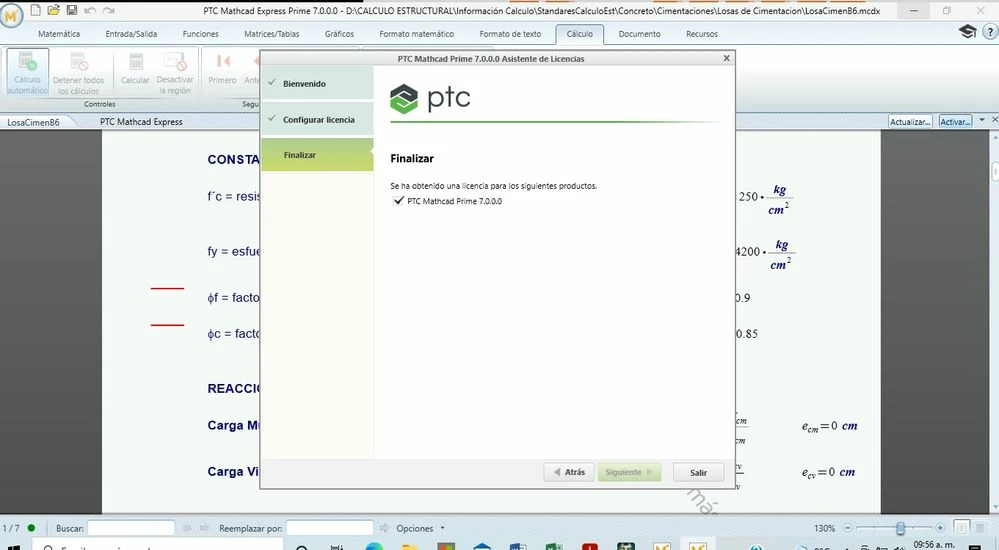

What issue do you get on the screen while configuring the license?
