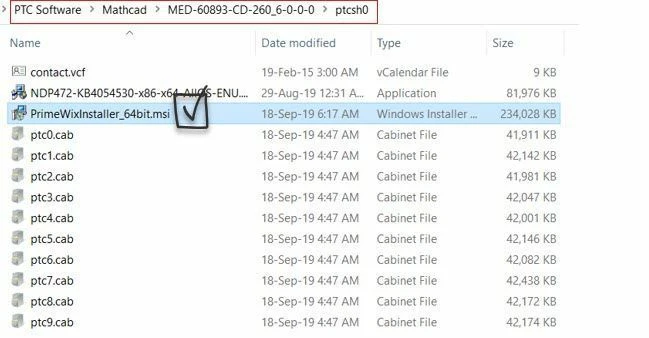

Run "PrimeWixinstaller_64bit.msi" from the "ptcsh0" folder of installer.
