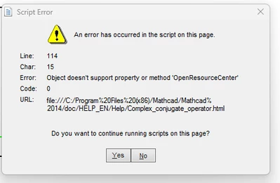

I had to install MCAD 14 on a new machine. To my great surprise, that went well, except that I cannot access QuickSheets. When I try, I get the message below. Can anyone help with this?

It's indeed surprising that you managed to install (and run?) Mathcad 14 on a new machine.
Did you install the resource center with Mathcad 14 (can you open QuickSheets from the "Help" menu)?

Yes, but a pleasant surprise. Yes, I can open the QuickSheets from the "Help" menu, which is good enough for me. Thanks for the suggestion.
Feb 14, 2024 3:36 PM UTC
I spoke too soon. I was not able to run MathCad 14. Does anyone have any suggestions for installing and getting to work on Windows 11. It is running for me on Windows 10.

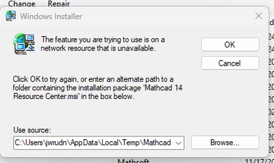

1. You can try repairing Mathcad 14 installation. Go to the "Control Panel" on your computer, select "Programs and Features," find Mathcad 14 in the list of installed programs, right-click on it, and choose "Repair."
2. What Windows OS are you using?
Feb 9, 2024 7:08 PM UTC
Thanks for the suggestion but when I tried it I rec'd the message
Using Windows 11.
But I discovered that I can access the Quicksheets from Help, which is good enough for me.
