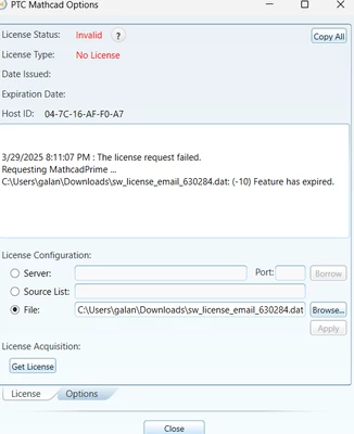

I m a student and i receive on email a sw_license_email.dat for mathcad but it does work

1. Verify the expiration date of the license file.
2. Article - "Error “FLEXnet licensing error: -10, Feature has expired” when starting PTC Flex-enabled applications":

What error do you see on your screen and at what step of the program installation does it occur?
