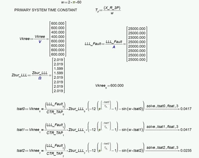

Hi, I have a question on: how to use a "solve" function inside a for loop or how to use it for solving variables from arrays or using the solve function inside a solve block? In the solve block, I can use Find or root functions but these methods don't give sometimes the exact solution to the equation on hand. And "solve" works the best for my case. Thank you for your help

    Here is one way using the root() function.
    Have assumed two vectors not defined in the image are all ones.

    Here is a screenshot of where I am using the solve function one at a time to get tsat values from 0 through 7. But can this be automated using a for loop or solve block, but by using the "solve" function?

    To save us a lot of typing can you upload the worksheet.  You may need to put the file into a zip archive to upload.
    CTR_TAP is not defined in the image.
    X_R_3P is not defined in the image
    In first equation should TP index 0 be used?
