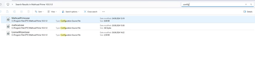

3-Newcomer
February 20, 2025
Hello!
I looked through the program files -->PTC--> Mathcad prime 10
And then tried to do the search function for ".config", and there is kinda no file with such a name (only these 3 files)
LucMeekes23-Emerald IVAnswer
February 20, 2025
No, you looked at the wrong place. You have to look in
C:\ProgramData\PTC\Mathcad Prime
to find the .config file(s), NOT in Program Files.
Note that C:\ProgramData is a hidden directory, but you can navigate there by entering the pathname in Windows Explorer.
One level deeper, in
C:\ProgramData\PTC\Mathcad Prime\Logs
you will find the log files, but they (most probably) will not help you.
