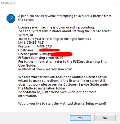

I have a problem with implementation a license into a server,
or more likely reading the license from the server.
I transfered a license from one server to another, using this instruction:
https://community.ptc.com/t5/PTC-Mathcad-Installation/How-to-Transfer-Mathcad-license-from-an-existing-Host-ID-to-a/m-p/788323#M1599
After transfering and implementing it on FLEX License Manager, with help from given instructions,
when i install mathcad 15 on my local machine and try to run it, this monit pops up:
Movement through port 7788 is open on the server, and FLEXlm service for PTC is up and running,
Didn't have any errors through the implementation process, restarting FLEXlm doesn't help.
Error no. shown: 96, 491.
January 17, 2023
Article - "Error "-96, License server machine is down or not responding" when launching Flexnet licensed applications": https://www.ptc.com/en/support/article/CS21768
January 18, 2023
None of solutions given there helped. 😞
