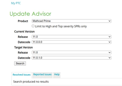

I'm trying to find out what was changed or fixed in datecode 11.0.1.0 compared to 11.0.0.0. If there is a summary of changes/fixes on the website someplace, I haven't been able to find it. I support our company's users and would like to be able to tell them what is changed in 11.0.1.0 before they upgrade their installed version.

"Bug Fixes" and  below shows no results.

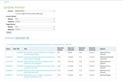

Hi @PaulOrtmann and @ppal_205706 ,
Please do check the Update Advisor for the fix in Mathcad Prime date code 11.0.0.0 to 11.0.1.0
The issue of the result not being shown has been fixed.

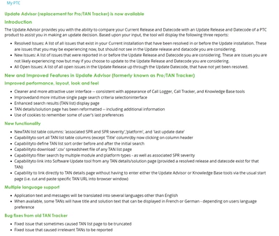

Hi @PaulOrtmann,
You can refer to this Knowledge article:
  • CS132280 How to access Update Advisor on PTC Support website
Note: (We are aware that the list of SPR fixed from Mathcad Prime Date code 11.0.0.0 to 11.0.1.0 are not shown and PTC team is working to fix it)
Dhiraj
