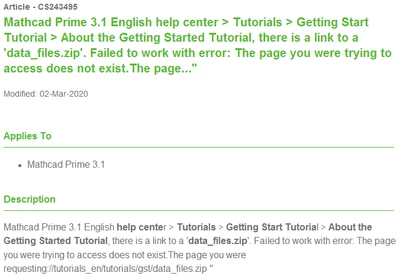

I've been asked to complete the Mathcad tutorial for a class, but when I open the tutorial and try to download the zip file, it reads
Page Not Found
The page you were trying to access does not exist.
The page you were requesting: /tutorials_en/tutorials/gst/data_files.zip
I was wondering if there is somewhere I could access this file so that I can complete the tutorial since it's assigned.

This is a known bug:
Considering that Prime 3.1 is very old software (Prime is at version 7)
And this bug was reported more than a year ago
I doubt if it will be fixed.
But maybe this helps:
https://community.ptc.com/t5/PTC-Mathcad/Getting-Started-Tutorial-not-working/m-p/254149
August 17, 2021
August 18, 2021
@RR_9189452,
  • This issue is fixed in Mathcad Prime 5.0/6.0
  • Workaround: Mathcad Help Center > Working with PTC Mathcad > Using Help Examples> To Copy Math Examples from the Help
