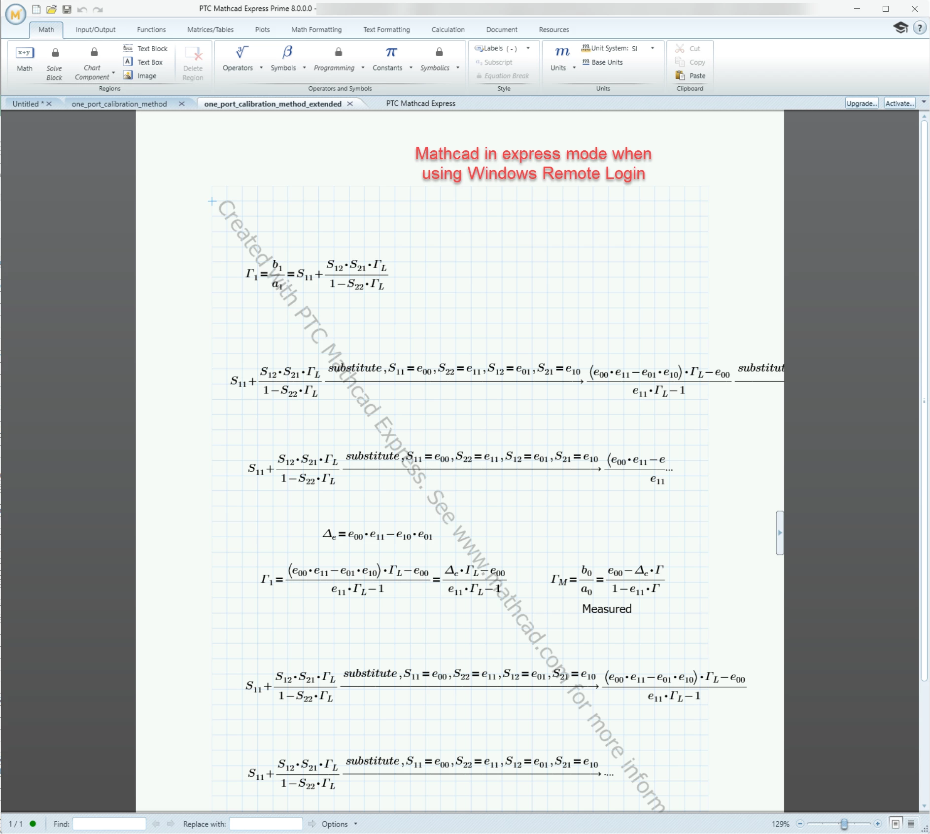

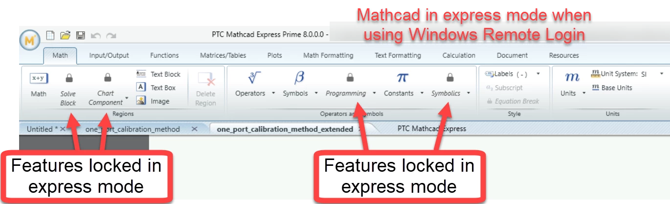

I have the professional version of Mathcad Prime 8.   However, when I remote login to my PC Mathcad Prime runs in express mode (feature limited + has water mark across the page).
Is there a work around for this?
