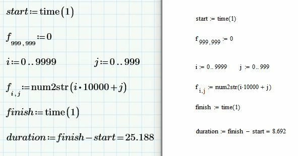

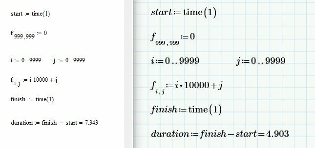

Hi
Thought I'd run some simple tests of speed in Prime and Mathcad.
Using numbers (up to about the matrix size that can be held in memory in Mathcad) Prime is slightly faster 4.9 to 7.3.  Prime can hold far larger matrices
Using text processing on a smaller matrix Mathcad is far faster than Prime 8.7 to 25.2
So it appears it matters what is being processed as to which is faster.  Prime is sad in text processing?

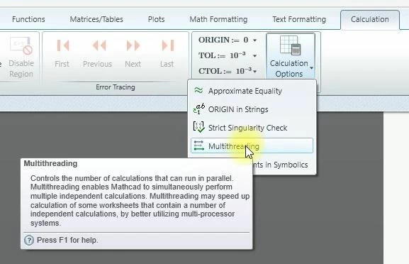

One suggestion is to set multithreading calculation option if you have a processor with a number of cores.
Cheers
Terry
September 21, 2021
Hi Terry,
Thanks for the reply.
However, Multithreading is selected and worksheet still calculates really slow!.
Cheers,
NH
