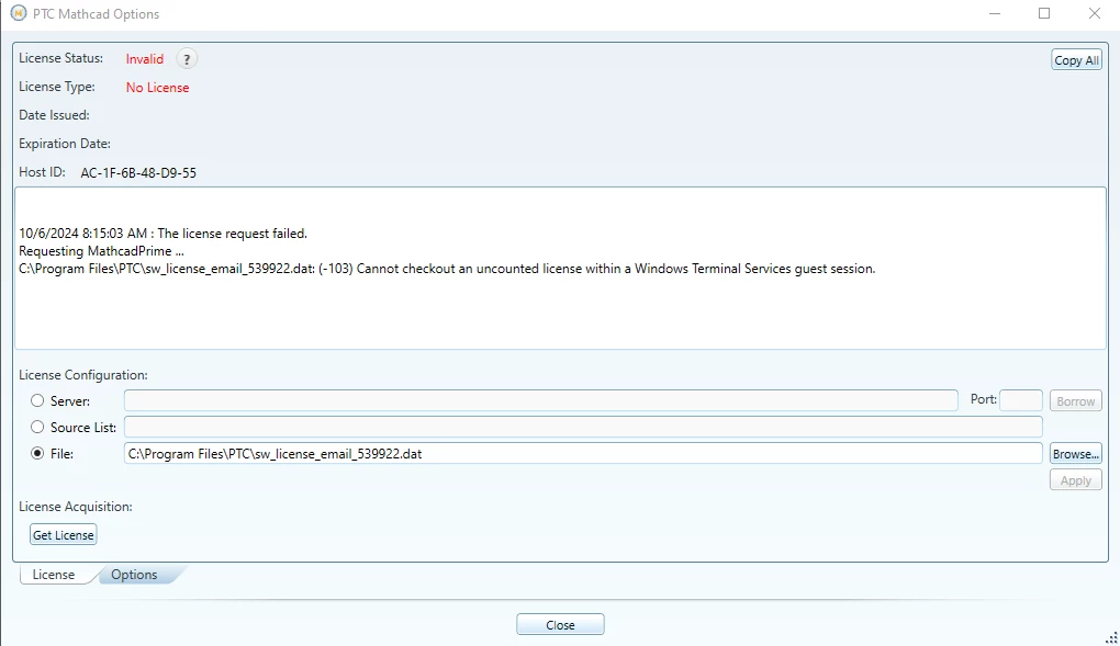

I am encountering an error while configuring the trial license for Mathcad Prime 10.
The error says: "... (-103) Cannot checkout an uncounted license within a Windows Terminal Services guest session."
FYI, I am running the software locally (not remotely).

Article - "Error "Terminal Server Remote Client Not Allowed" or "(-103) Cannot checkout an uncounted license within a windows terminal services guest session"": https://www.ptc.com/en/support/article/CS23456

Thanks for the reply, but I still don't get what I need to do to resolve the license issue.

  • If application is configured to a locked license, then the application will not launch when connected over a remote Desktop or Terminal Services connection
  • A locked license file is intended to be used alone, without using any License Management Application, whereas a floating license file is intended to be managed by a License Management Application installed on the server machine.
    Check first if License file is Floating or Locked.
    Reconfigure applications license:
    • Reconfigure Mathcad with correct license
    If another type of license is needed instead:
