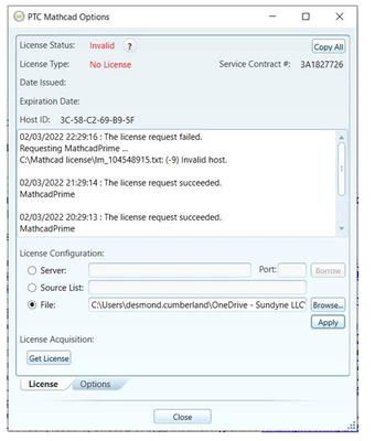

I have a user that everytime a Microsoft update is pushed must reinstall mathcad because the license request failed. is there a listing of registry edits made during install that we can then be sure not to modify when making changes?

1. What version of Mathcad are you using?
2. Please provide a screenshot of the error that occurs.

we are using prime 7
March 31, 2022
Compare the "HOST ID" with the one specified in the license file.
