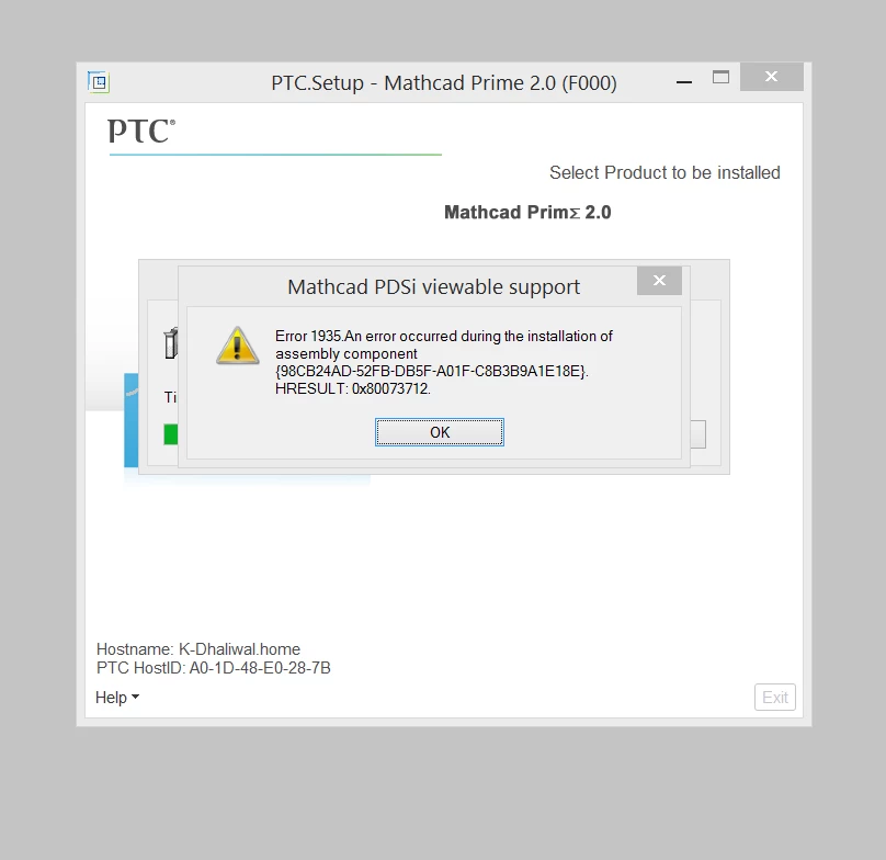

Hi All,
I have an older version of PTC software.
It is Prime 2.0.
This does all my needs.
I had to re-install it recently because it was hanging up or closing down while it was uploading.
Just days before it did an automatic online license check, and it passed.
I had Prime 2.0 for several years since it first came out.

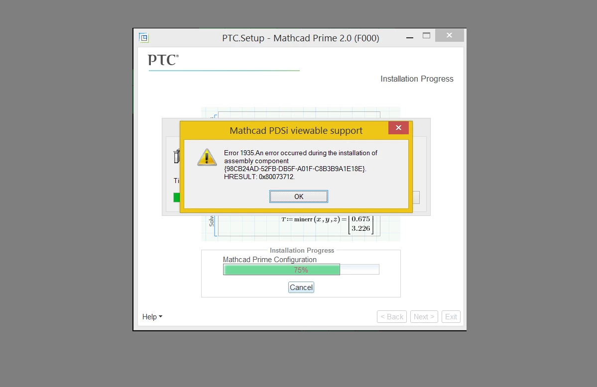

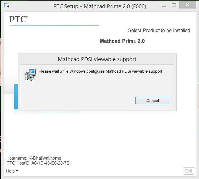

On attempting to re-install its failing to do so.
Message is about a component was not installed.
The screenshot is attached (Error2).
I have installed WindChill....software.
I direct the browser to the license file (single user).
The install continues and then stop with this message.
Error 1935 An error occurred during the installation of assembly component.
Next a file name in brackets [.......].
Followed by HRESULT:0x80073712.
That is the information I have on my failed install.
I will appreciate any and all help you have to get me back on with Prime 2.0.
PS: The first error is indicated in file name Errorr.
The 2nd error the most recent re-install error details provided above is in file Errorr2.
This happens during the installation at Mathcad PDSi viewable support.
Screen shot on this is Errorr3.
Karl Bogha.

KarlBogha14-AlexandriteAuthor
Hi Ms Catalina,
I replied to you via email on this that I will be back on it soon.
I have cleaned the registry on Prime and Mathcad, maybe need to specifically pick Windchill...
Which I now remember I may have not done so. Though it was uninstalled.
I re-installed it yesterday and it went thru the process like the last time where it failed.
It stalled at the same spot on 'PSDi' section of the installation which maybe the last part on install.
This time I got the file name the error message listed, which maybe a registry file, but I failed AGAIN to find this file in my registry. File in brackets below
{98CB24AD-52FB-DB5F-A01F-C8B3B9A1E18E}.
It also gave the same the error message on the dialogue box HRESULT:0x80073712.

While I don't use MathCAD Prime, there ae some things to be aware of.
All versions of MathCAD prior to Prime 7 can no longer be sold due to a sub module licensing issue.
Have you tried to completely remove the original installation of Prime 2, including a search through the registry to delete any remnant traces to it? When I do Windchill installs, I always clean the registry of any traces of the prior location that Windchill was installed in.

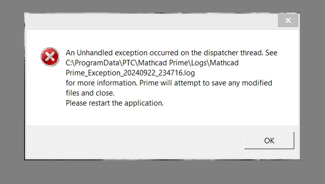

Hello All at PTC Prime-Mathcad,
First thanks for the help so far, I made some progress.
I got busy with my work and did not get back to this.
I have gotten past the PSDi installation!
This was an Adobe associated file that got installed separately during the recent installation a few days ago.
But I am having a hang-up with a new error message.
It may have to do with a Microsoft Net file from the Windows 7 and 8 days.
I got an error message log file after the installation process this time.
It appears after I click on the Mathcad Prime icon.
Which is a step better than the last time.
Error message: 'An Unhandled exception occurred on the dispatcher thread'.
Followed by the file location on my computer.
The error log file is attached.
You out there at PTC Prime-Mathcad may be able to help me with this.
Appreciate your assistance.
