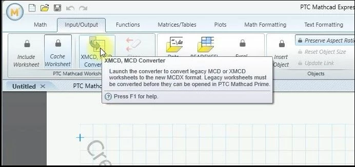

There is a converter Mathcad to Prime.  It is not included ina default install and needs to be specifically chosen during the install.
Converter can be opened from an icon on the ribbon.

Just re-install the application, and don't forget to tick the option for the converter ON.
Note that you will NOT get an extension to your 30 day trial period. I see you've got one day left. Hurry!
June 20, 2024
Bear in mind that your installation of Prime must be licensed. For a trial version, that means you have to have gotten a license for the (30 day) trial period and still be within that period. If not, the only information that you will get from the converter is the version of the .mcd file.
