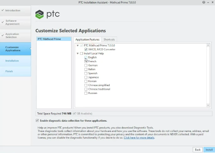

Unable to open .xmcdz files. Can anyone please advise, how to open ... or how to convert the file format which I can view and modify!
Best answer by VladimirN
Starting from the 7th version of Mathcad Prime you can use the built-in converter (before the installation process, it is necessary to select it among the installation components).
VladimirN24-Ruby IVAnswer
July 7, 2022
