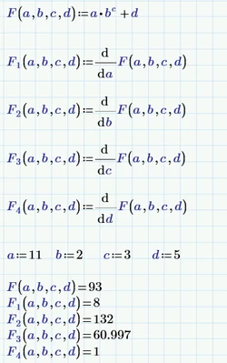

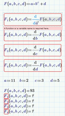

I think you've found (yet another) bug in Prime concerning functions with more variables.
This is Prime 9:
This is Prime 10:
You should file a bug report to PTC regarding this.
Prime 11 is supposed to be coming out soon, and we can only hope that it is fixed there.
In the mean time you could use Prime 9 instead of 10, because the bug is not in there.
I pretty confident that your license for Prime 10 allows you to also run Prime 9 (and 8 and 7). So if you have Prime 9 on you machine, use that.
