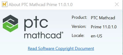

    I have
    but my PDF is searchable :
