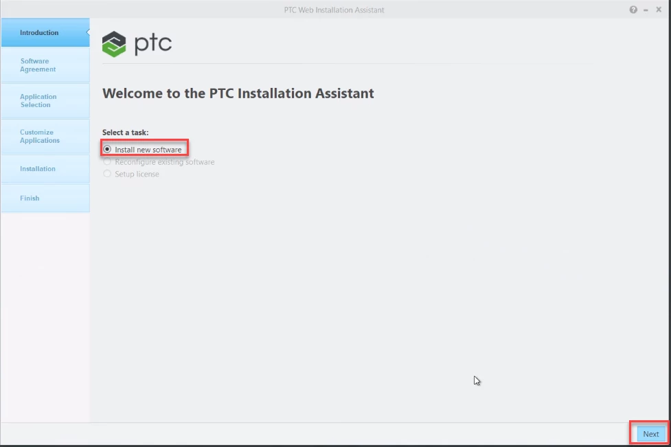

1. Select #Install new Software and Click on #Next

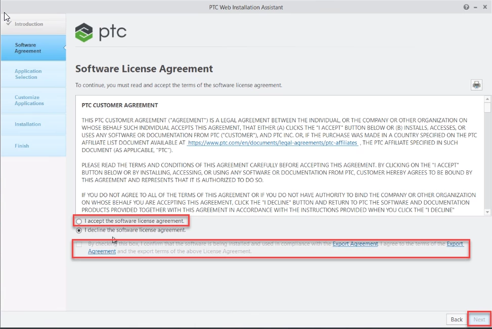

2. Select #I accept the license agreement and Check the box for Export agreement then click #Next

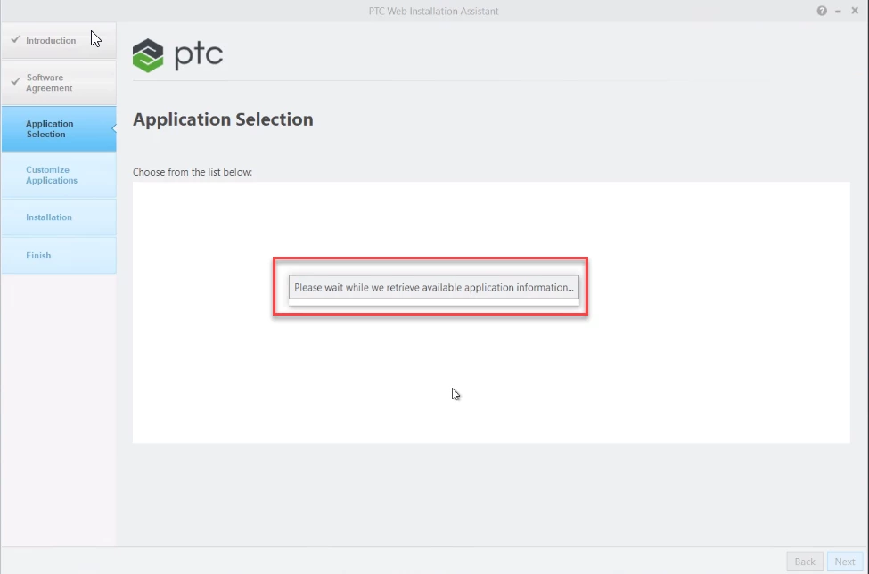

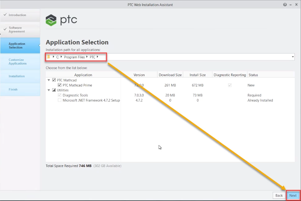

3. In the Application Selection screen, Change the installation directory, if required. Else, Prime 7.0 will get installed in the default location shown
  • Use option #Customize to change the help center language or to install help center in multiple languages and to set locations for shortcuts for Prime 7.0
  • Choose list of applications need to be installed. By default, all the applications are checked
    • PTC Mathcad Viewable Support is required when using Windchill integration, users who do not use Windchill integration may uncheck this component
    • To get more information on each of the listed application/utilities and customize, refer to page 20 of Prime 7.0 Installation Guide
4. Select #Next.

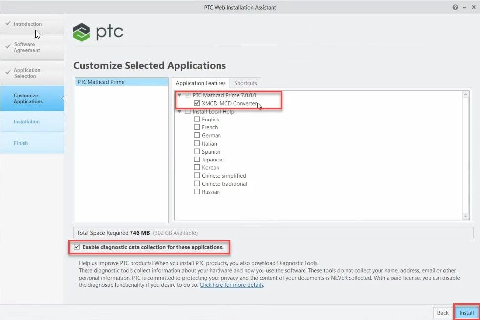

This will trigger a new window  "Customize Selected Applications".
Customize Selected Applications:
Use this to Install Standalone Converter with Mathcad Prime 7.0 and local help center in multiple languages also, to modify the windows shortcut settings for Prime 7.0. Choose list of applications need to be installed. By default, all the applications are checked.
5. Select #Install to start the Installation

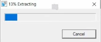

I've been having problems! The installation process crashes at 1% and it does not explain why
October 18, 2021
My instalation doesn't even get to point 1. After extracting window disappears and instalation assistant never turns on. Can someone help me? I have mathcad prime 5 license
October 19, 2021
Try the following steps:
  • First run "pim_installmgr_mathcad.exe" and when it gives "error at 1%" after downloading files,
  • go  (Windows 10) "C:\Users\YourUsername\AppData\Roaming\PTC Download\MED-XXX-XX-XXX_X-X-X-X\ptcsh0\",
  • run "PrimeWixInstaller_64bit.msi" installation file.
