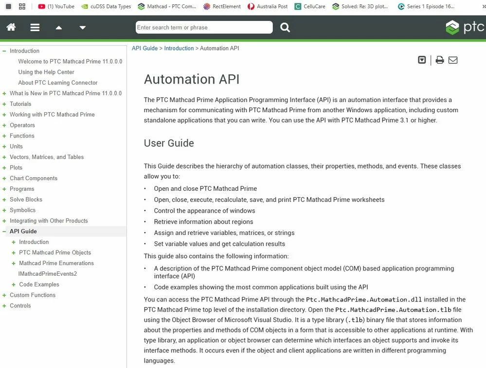

SDK is called an API in Prime
The API is included with a Mathcad Prime full license.
There are some good examples provided in help of how to create Custom Functions or Applications that use Prime for many languages.
It is suggested to look at them.
What programming language have you chosen from the ones available in the API.

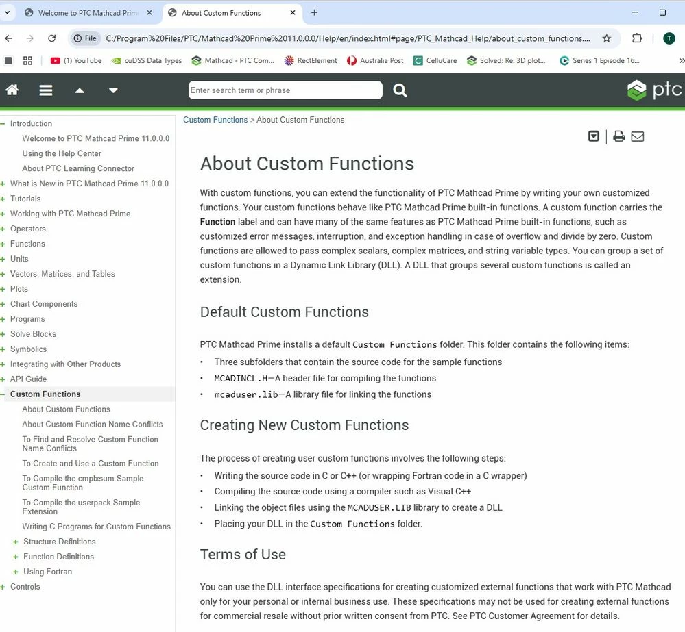

Just to be clear.  Custom Functions can only be written in C, C++, or Fortran in a C wrapper.
Cheers
Terry
