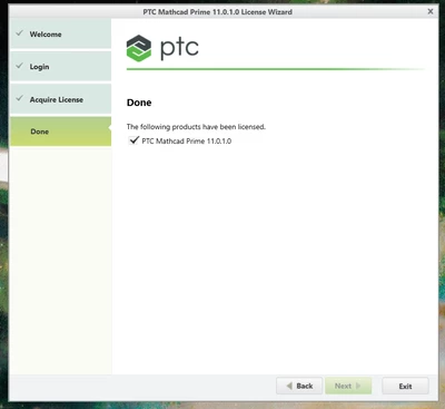

hi, so, i installed mathcad and when i try to open the app from the shortcut it wont open, like the app isnt even trying to open (load screen doesnt appear). the license wizard is working tho, butttt right at the end of licensing the next button wont activate. I activated the license via my student account on ptc. Please help.
also, my license is working just well on another laptop, and the mathcad works just fine, but not on my laptop. any ideas why?
and, maybe its important, but the mathcad prime installation assistant is black instead of white like on the laptop mathcad is working.

23-Emerald V
According to the screenshot you're 'Done'. There is no 'Next' (that's probably why it's grayed out). The logical option is 'Exit'.
