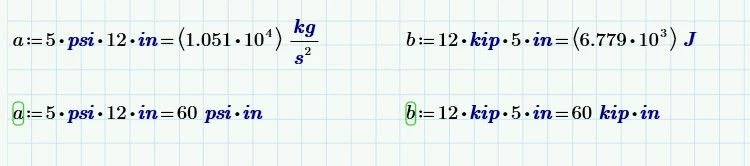

Units are converting wrong, when I have psi multiplied by inch it gives me units of (lb/s^2) and when I do a kip multiplied by in it is giving me units of ((lb*in^2)/s^2)

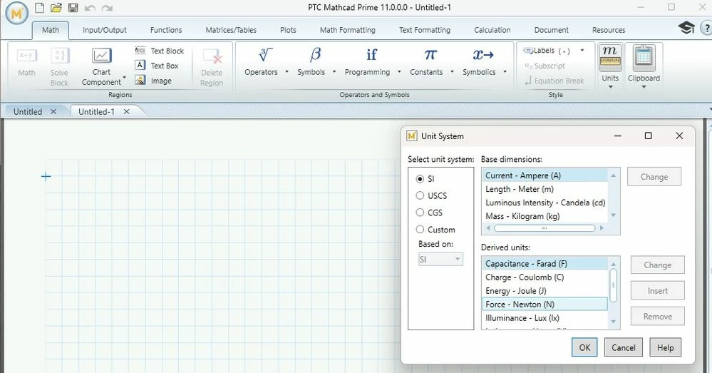

The result of any unit calculations are expressed in the base unit system of the calculation sheet.  All you need do is change them to non-base units of your choice.  For instance this sheet has the SI units as the base units of the sheet.
Cheers
Terry
September 12, 2025
Cheers
Terry
