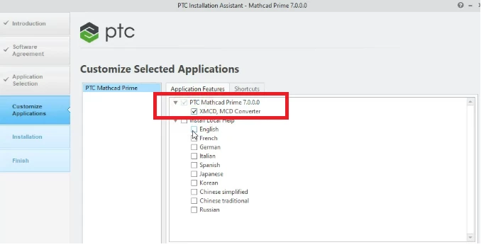

xmcd converter install
How to install XMCD converter
VladimirNAnswer
November 17, 2022
Starting from the 7th version of Mathcad Prime you can use the built-in converter (before the installation process, it is necessary to select it among the installation components).
VladimirN24-Ruby IVAnswer
November 17, 2022
