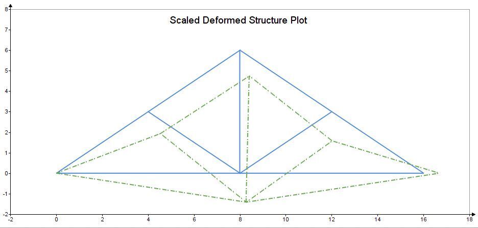

Plane Truss Mechanics
Can you use Mathcad to solve this problem?

  • Allowing the user to change the material via a Combo Box Input Controls.
  • Depicting the results with a Chart Component, such as the truss in the deformed shape, or the deflection at D due to changing input loads.
  • Making the problem more open-ended, such as using matrices and programming for different geometry and loading.

Jan 29, 2022 6:54 PM UTC
Here is another solution to the truss problem. The objective of this solution is to provide a teaching tool to be used in a statics of strength of material course at the sophomore level.
terryhendicott
Jan 31, 2022 8:58 AM UTC
Hi.
Interesting.
The same force in the members is arrived at in each approach.
The downwards deflection of the middle point D is different in each approach?
0.163" by stiffness method 0.05" by virtual work?
I have looked closely and the E used in virtual work method is Steel, and in stiffness method Aluminum.
