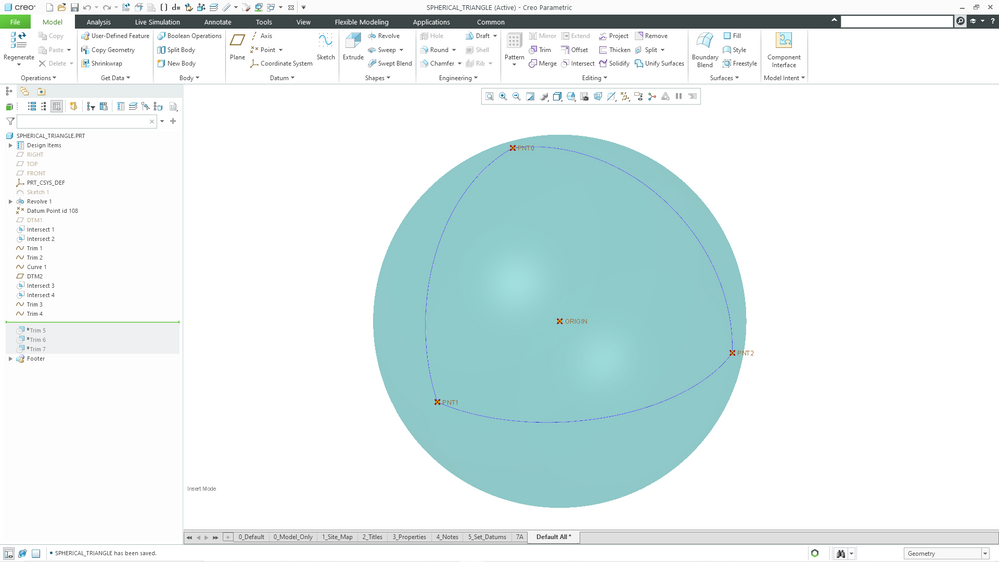

Here is a 3D model in Creo 9 of the sphere and points:

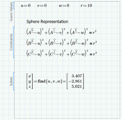

Thought I would get the ball rolling.
The coordinates supplied for three points on the sphere are correct the origin of the sphere is not at 0,0,0.
Enclosed is my solution and 3D model checking of the procedure to calculate the area.
Fulfilled the first option with a program that solves for area given three points on the sphere and a radius.
Used the program in some test cases.
Cheers
Terry

For verification, I have attached the original model that I used to construct the problem. I believe I created in Creo 9.

As pointed out by Terry - still works with the original data but the center is as follows:

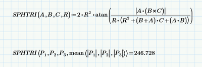

Jul 12, 2022 10:39 PM UTC
The equation cleaned up a bit.
18-Opal
Jul 18, 2022 11:46 PM UTC
FINAL - No more.
Compacted.

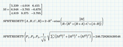

18-Opal
Jul 20, 2022 12:32 AM UTC
To myself:
or maybe this looks better?
18-Opal
Jul 25, 2022 3:37 AM UTC
or

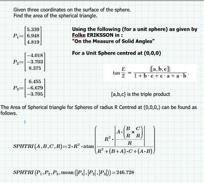

Aug 7, 2022 7:31 PM UTC
My try

Aug 8, 2022 6:03 PM UTC
Some of the elements building up to calculation of the area can be useful too. Here is a version that shows those details.
