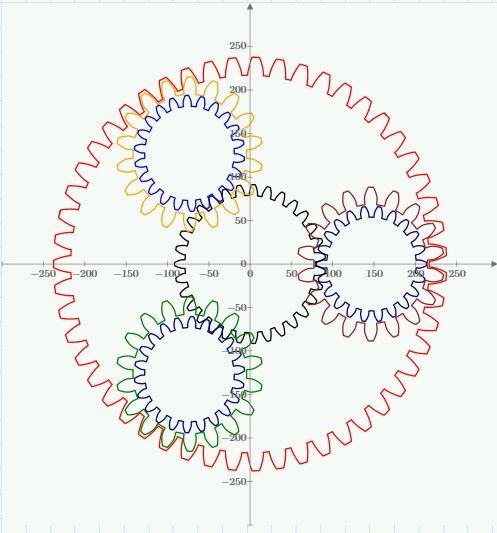

Solutions so far have covered the topic excellently, so thought I would expand.
Drawing of optimum configuration of Sun, Planetary, and Ring gears.
Have yet to draw the other planetary gears but time is running out.
terryhendicott

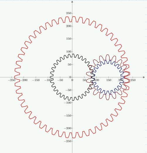

Apr 1, 2022 5:52 AM UTC
Know its late.
To position gears P2 and P3 in the system need to track the epicycloid and center of P2/P3 rolling around the sun gear.
