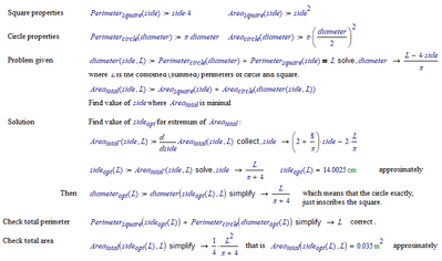

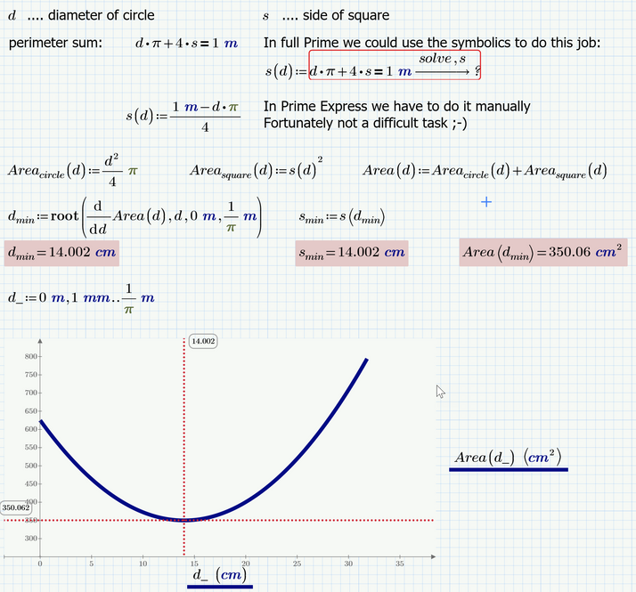

terryhendicott
May 4, 2022 5:16 AM UTC
I'll bite.
Here is one way.
Cheers
Terry

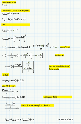

18-Opal
May 4, 2022 9:35 PM UTC
Prime 7 attached - runs on express too.
Plot as done by
23-Emerald I
May 14, 2022 4:44 PM UTC
Good solution.  But it won't run in Express (no symbolics, no polyroots)
May 16, 2022 1:48 PM UTC
Also "Minimize" (even without a solve block) is a premium function.
But the derivative operator and the "root" function are not and you can use them for a solution in Express. You just have to manually solve a simple equation 😉

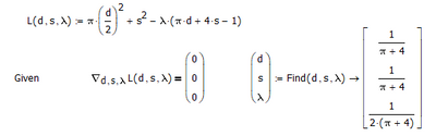

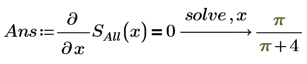

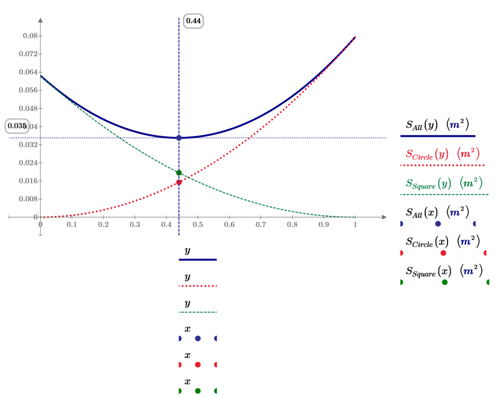

ttokoro
May 11, 2022 4:47 AM UTC
t.t.
ttokoro
May 16, 2022 6:22 AM UTC
Prime 8 (No Express) version 2.
Let x shows the perimeter of the circle. If x is the answer to minimize the toral area,
t.t.

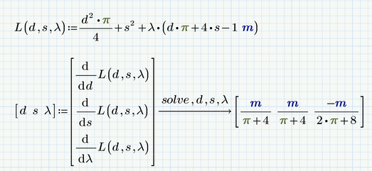

6-Contributor
May 16, 2022 11:16 AM UTC
I contribute with an analytical approach.
//cheers,
  bengt

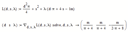

May 16, 2022 10:57 PM UTC
18-Opal
May 16, 2022 11:14 PM UTC
Bit of labelling would be helpful. This is like a flaming Homer.
But Short and simple.
Attach file please.
May 16, 2022 11:29 PM UTC
Attach file please.
Moe is using real Mathcad and this seems to be a Prime only challenge. Nonetheless I would vote for his solution being the winner.
BTW, because Moe's nice compact solution is using Lagrange and the Nabla operator - is the Nabla operator now finally available in Prime 8 or is it still missing?
We could make Moe's solution even a bit more compact by using the symbolic "solve" instead of evaluating the solve block symbolically (which is something not allowed to do in Prime anyway).
It could even be made a one-liner (but I wouldn't suggest doing so):
If the Nabla operator still is not available in Prime, you would have to do it the hard way
As usual Primes infamous auto-labeling bug required to manually re-label some variables to make it work.
I seem to remember to have read that PTC planned to implement a partial derivative operator. While being only an optical display thing it would be appreciated. Is it already implemented in Prime 8 or was I just reading the roadmap for future versions?

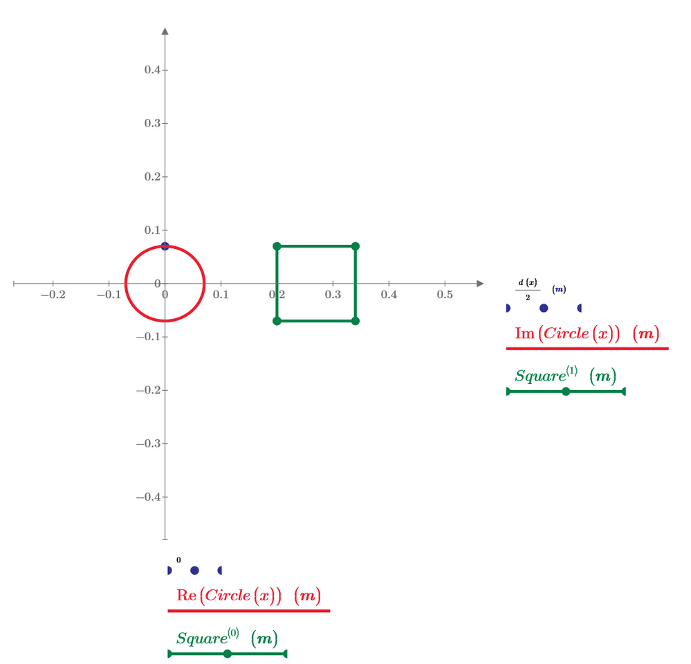

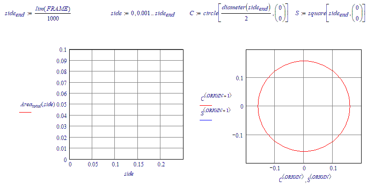

23-Emerald V
May 23, 2022 9:23 PM UTC
I thought I'd add my 2 cents:
And since a result without an animation is not a solution....
18-Opal
May 23, 2022 9:37 PM UTC
I opened in mathcad 15
Get errors:
May 24, 2022 11:59 AM UTC
This worksheet from 11th version of regular Mathcad.
