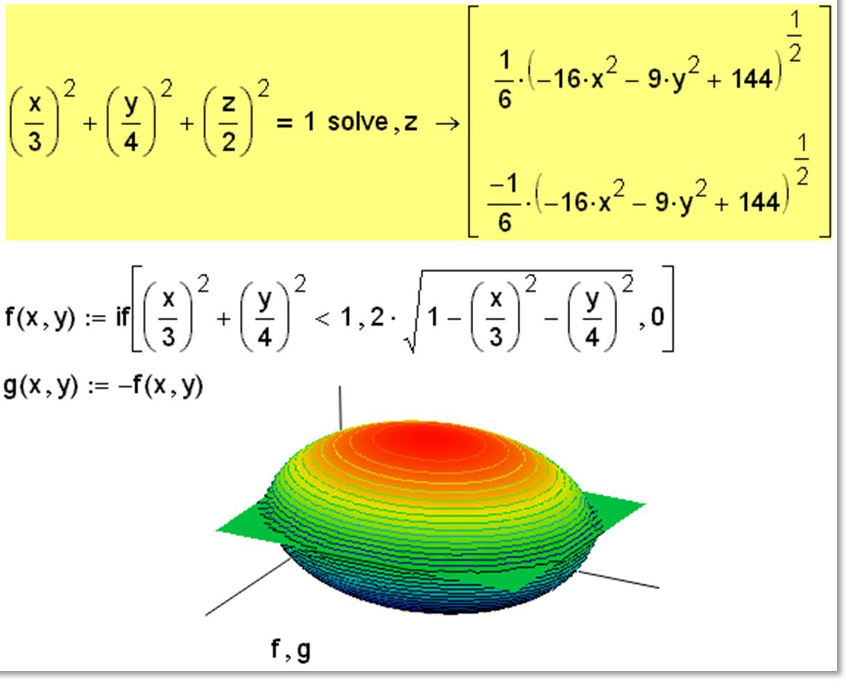

Sorry, Luc, I couldn't find a way around using Solve Blocks and Programming...

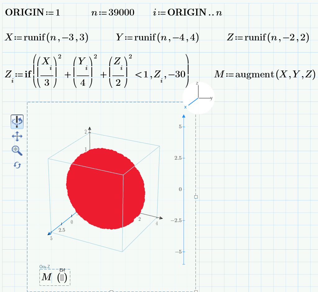

One other way
Mar 29, 2016 6:42 PM UTC
Prime
Mar 29, 2016 6:50 PM UTC

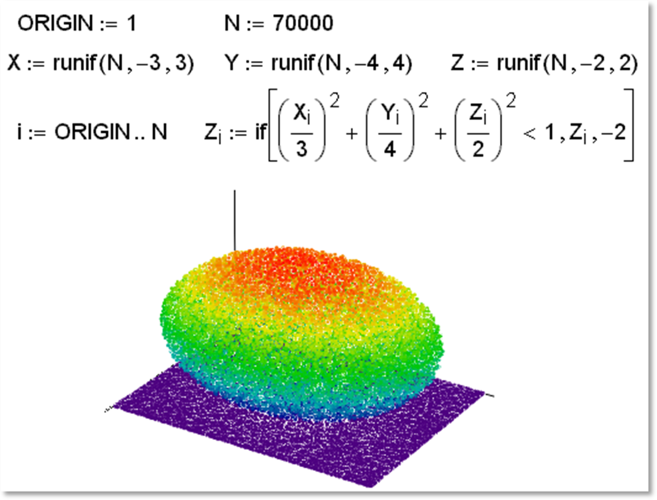

Hi Valery!
Here is your "egg" done in Prime.
Advantage is the possibility to use NaN in 3D-plots.
Disadvantage is that Primes plotting capabilities beats everything - in the negative sense.
Lets hope that the third party plot program in Prime 4 will be something worth using.
WE

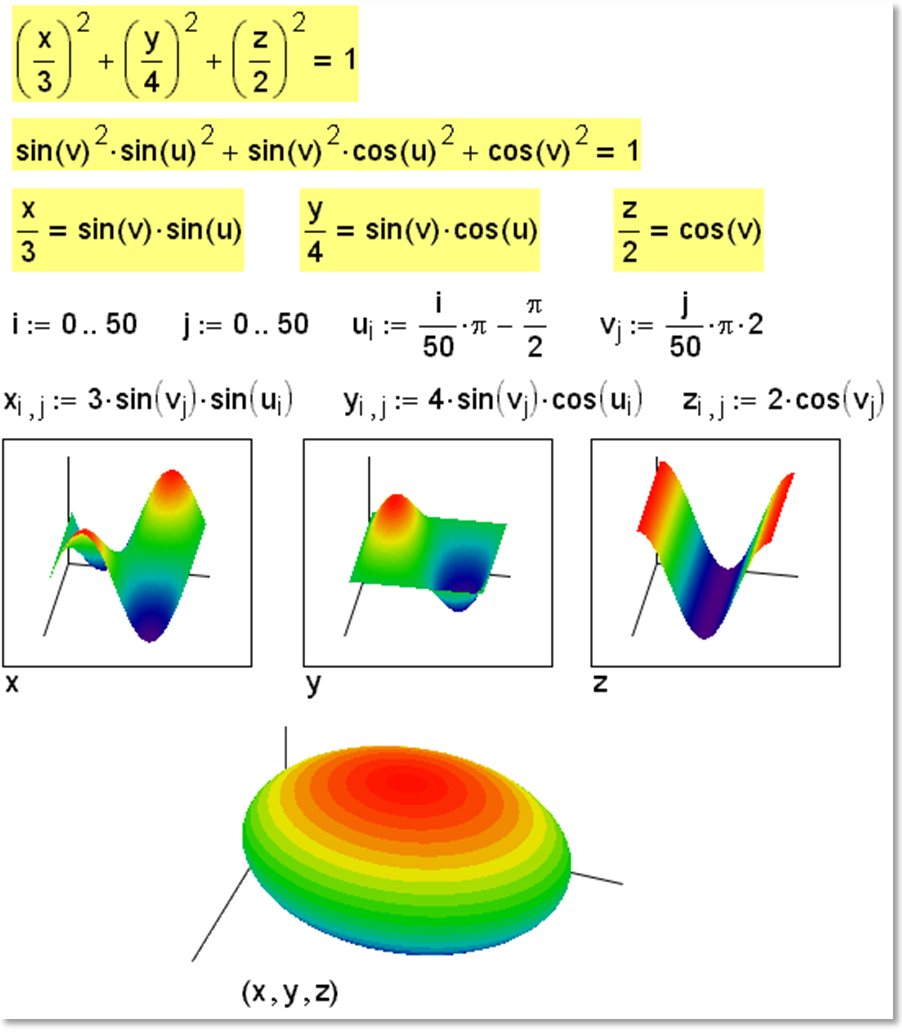

Mar 30, 2016 5:33 AM UTC
Thanks, Werner!
One more
Read please about this trick Painting and sculpture in a medium Mathcad
