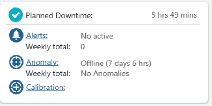

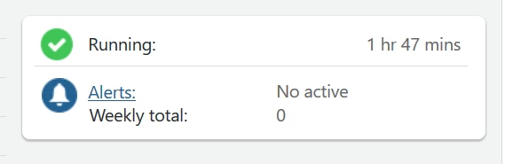

What should i do  if i would like to show  anomaly status in asset advisor(MFG version 8.2)
this is pic MFG 8.1
this is pic MFG 8.2

Greetings Nuttaphon,
Anomaly information, such as status, duration, and calibration, has been removed from the Asset Advisor (MFG version 8.2). This information can be added to your system as a customization.
The anomaly detection functionality can be enabled and configured through the ThingWorx platform.
For more information, see “Anomaly Detection” in the ThingWorx help center, available at the following URL:
http://support.ptc.com/help/thingworx_hc/thingworx_8_hc/index.html#page/ThingWorx%2FHelp%2FComposer%2FAnomalyDetection%2FAnomalyDetection.html%23
