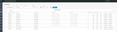

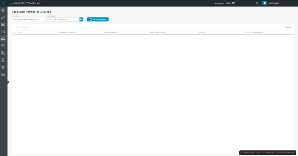

I have completed everything till Scheduling, but when I went in Execution I couldn't find anything?
My stations are enabled and JobOrders are created.
I also got an Error stating-->Production Status for "Scheduled" cannot be resolved

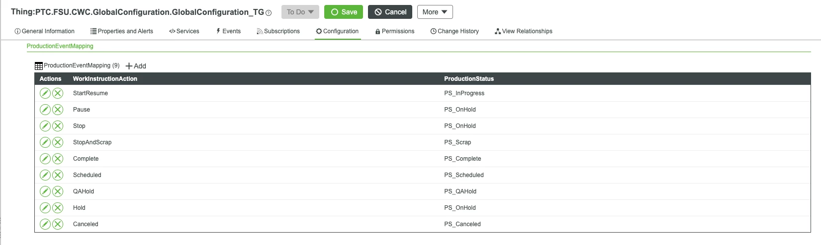

Hey @RG_10417299
please make sure you have the correct production statuses created in the database, including one for Scheduled and Canceled.
Ensure that you setup the mapping for the production status and the CWC status on the PTC.FSU.CWC.GlobalConfiguration.GlobalConfiguration_TG Thing in the ProductionEventMapping configuration table.

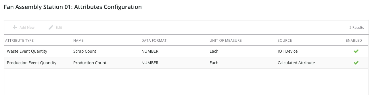

Also your work station needs to have a property linked to Production Event and one to Wast Event.
