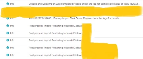

I configured a device for monitoring its parameters using Asset advisor (Thingworx apps - 9.1) and control advisor for kepware connection
I exported it using 'Export configuration data' option and imported it in another Thingworx apps version 8.5 but not able to see the device.
have attached the application logs.

@Sruthi : Seems like you are trying to export entities from a higher version(9.1) and importing to a lower version(8.5). This usually is not supported in thingworx. I would suggest to import to same or higher versions.

oh, ok thanks for the information.
