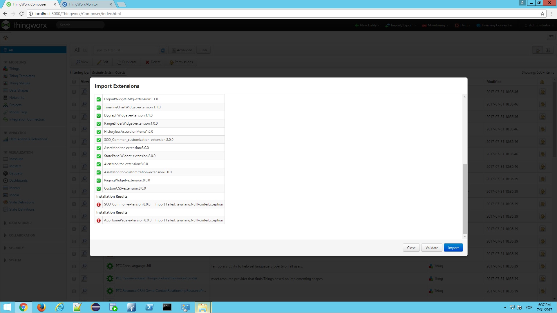

Asset Advisor OEM Failed to import
The error messages is like the image above:
SCO_Common-Extension:8.0.0                    Import Failed: java.lang.NullPointerException
AppHomePage-Extension:8.0.0                    Import Failed: java.lang.NullPointerException
I need some help here. What could possibly be wrong here ? Did Someone face the same issue before?
Thank you,
Vinícius Xavier.

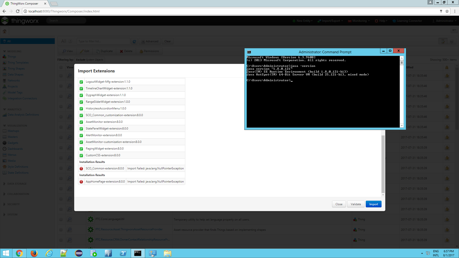

Hi Vinicius,
Java configuration for tomcat is referring to 1.8.0.121 version of jre which looks good to me.
I would suggest you to restart the server and import the extension again.
If the issue still persists , i would recommend you to redeploy the Thingworx.war again.

Hey Vinicius,
Looks like you don't have the requisite JRE/JDK installed.  Can you verify that you have JDK 8 Update 111 installed?

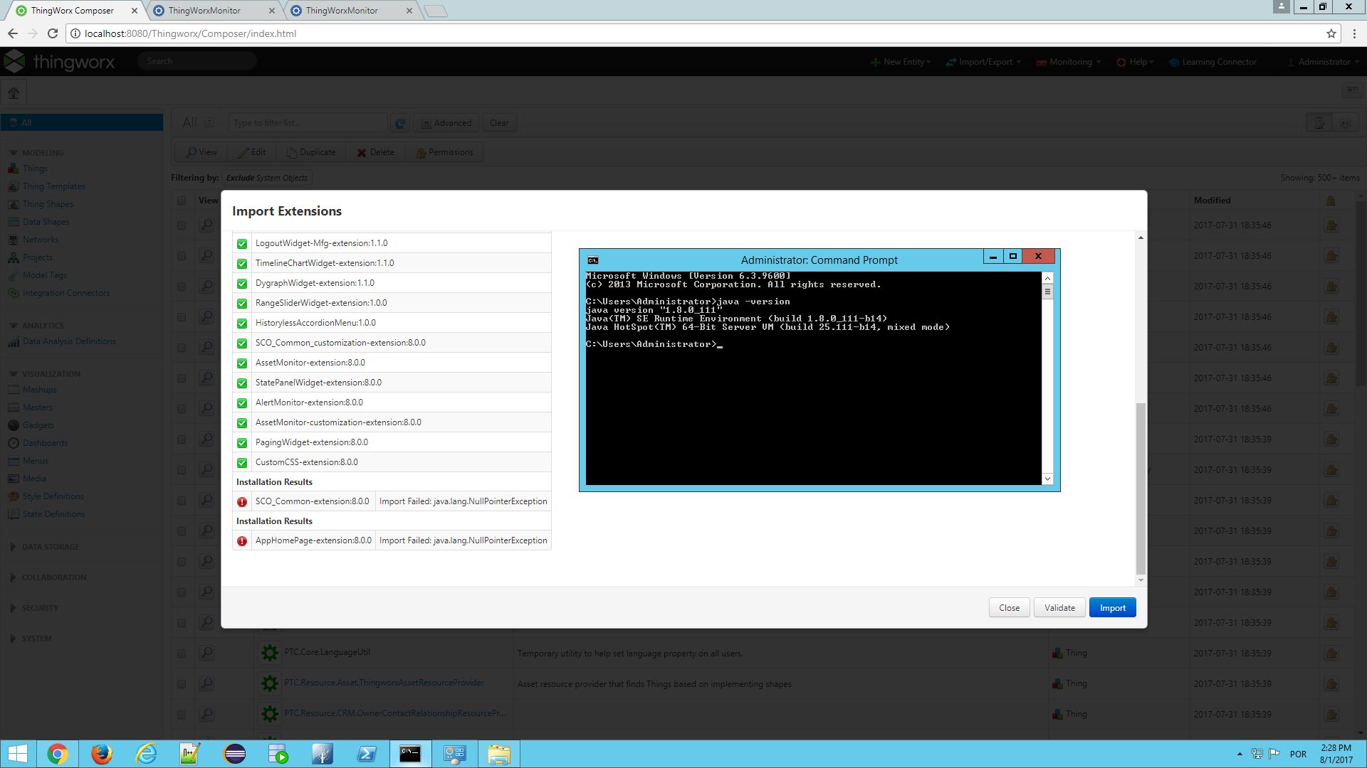

Yes, I have JDK 8 Update 111 installed.

Checked the extensions for SCO_Common-Extension:8.0.0, AppHomePage-Extension:8.0.0 and found out that the JDK Version used for Build is 1.8.0_121.
Could you please try the import again by upgrading the Java version on your system.
Himesh Rajpal
vxavier5-Regular MemberAuthor
August 1, 2017
The same problem again after the java update.
