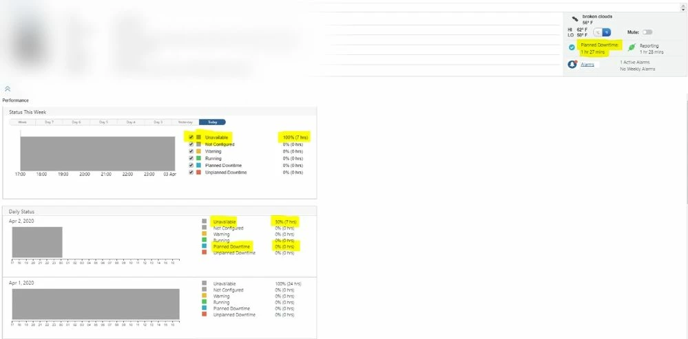

Asset advisor performance charts not reflecting asset status history
For some reason, the performance charts do not reflect the asset status history anymore.
The expressions for the asset are set programatically during asset provisioning as follows:
Things[UserInputSerialNumber].EXP_E_Running = "\"" + UserInputSerialNumber + ":AssetStatus\"=2";
Things[UserInputSerialNumber].EXP_E_NotConfigured = "false";
Things[UserInputSerialNumber].EXP_E_Unavailable = "true";
Things[UserInputSerialNumber].EXP_E_PlannedDowntime = "\"" + UserInputSerialNumber + ":AssetStatus\"=4";
Things[UserInputSerialNumber].EXP_E_UnplannedDowntime = "\"" + UserInputSerialNumber + ":AssetStatus\"=3";
Things[UserInputSerialNumber].EXP_E_Unavailable = "\"" + UserInputSerialNumber + ":AssetStatus\"=5";
When the property "AssetStatus" is updated, the property "statusTimestamp" is also updated with the current datetime.
Am I missing something?

Apr 7, 2020 8:48 PM UTC
Additional information:
When I update the status, I update the following properties:
AssetStatus
status
statusTimestamp
Example:
Things[thingname].AssetStatus = 4;
Things[thingname].status = 4;  //I update this manually so that the asset advisor status reflects the asset status immediately instead of waiting for asset advisor to scan the expression for the status and update the status.
Things[thingname].statusTimestamp = new Date( );

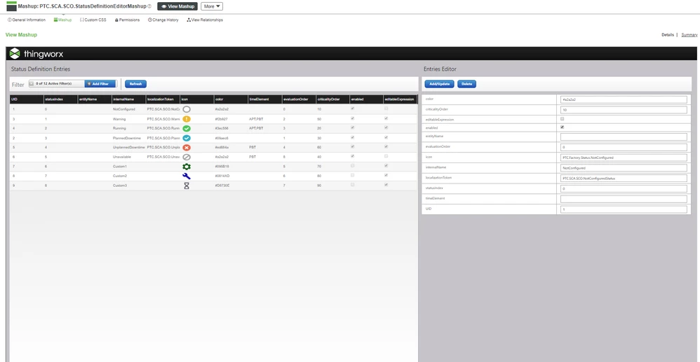

Apr 8, 2020 9:51 AM UTC
Hi @Willie
The status expressions are evaluated in the order that they appear in the table. The first expression to evaluate to true determines the state of the equipment. Could you please change the order of the status expression. I could see that from the above post that unavailable status is above the PlannedDowntime.  Additionally, could you please verify the value of properties Status, StatusTimestamp and EXP_E_PlannedDowntime from composer.

I just removed some extra lines that were unnecessary.
*******new set of lines to set properties for status expressions******
This doesn't affect the issue I'm having though.  Also, I don't think the order of the properties I set during asset provisioning affects the order they appear in the table.  The order they appear in the table is set by default.  Please see below:
The issue I'm having is not specific to "Planned Downtime" status.  Regardless of what the current status is, the performance chart does not update anymore.  The properties status, statusTimestamp, and the expressions all have the correct values; however, the status and statusTimestamp do not reflect these values.

Apr 28, 2020 4:12 PM UTC
Hi @Willie ,
Unavailable expression is not editable as per the product design
As per the status functionality, anyone of the asset status should be true for displaying asset status in asset advisor. In case if none of the above expressions are true, then asset status will be Unavailable (Hardcoded 5 to true) and this will be evaluated in the last when all OOTB and custom expressions gets evaluated.
