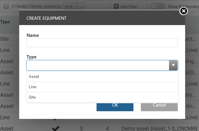

I want to add asset and line type to create equipment pop up panel as in the attachment.
Also, I want to assign asset detail mashup to each asset or line type.

Of course, according to the guide, I can add assets or lines. However, I want to add an asset through a predefined asset template. The asset template must have a separate asset detail mash up.
Can I add these asset types(Template)?

Hi @yonkim,
Yes, you can create custom template as per your requirement. The detailed steps are provided under Adding Custom Subtypes of ThingWorx Apps Customization Guide
