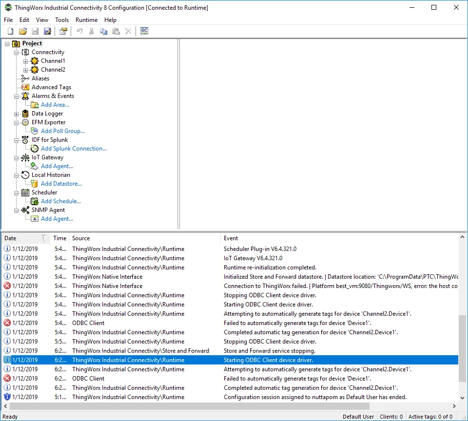

Can't generate tag from Microsoft SQL database
I try to get data from Microsoft SQL database 2014 to Thingworx connectivity but it has error message " Failed to automatically generate tags for device 'Device1'."
I would like to know what is wrong in this case
please suggestion  me thank you.

Hi @Nuttapol.
Please provide more details.  Is SQL Server configured as a data provider?  Are you using another app for pulling the data?  Is that the full error message or can you provide more details regarding the error?

How should i do if i would like to get data from SQL database to Thingworx industrial connectivity.
I do not use other software. I use Thingworx industrial connectivity only.

Hi Nuttapol,
This is a fairly common issue. There are a few things that could be at play.
Does the SQL server use Windows auth or Mixed mode? I am hoping you are going to say Mixed mode, and you have a SQL username and password.
Was the DSN configured as User or System DSN with the 32 bit version of SQL native client driver? Here I am hoping the answer is: Yes it’s a System DSN, built with the 32 bit SQL native client driver.
Is ThingWorx Industrial Connectivity’s runtime running as a service or in the interactive mode? The default is Service.
The ideal way to run is, as a service, to a system DSN, connecting to a SQL server that is using mixed mode auth, using your SQL username and password in the channel properties for the ODBC channel.
