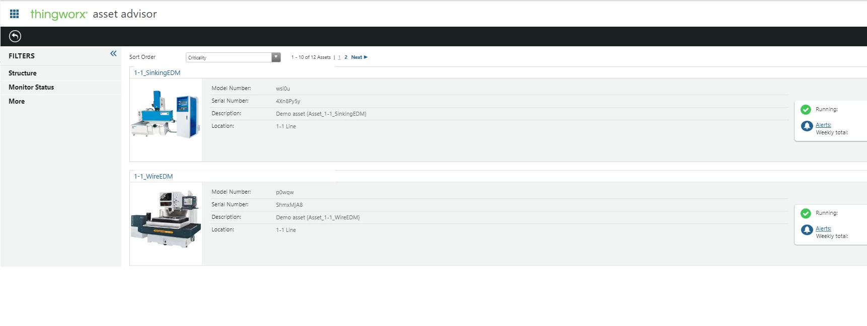

I had installed manufacturing apps 8.4.3 extension on Thingworx plaftorm 8.4.5 with PostgresSQL 10.
The installation went ok (without errors) but I can't see the filters in the asset advisor window (attached is the screenshot). I am logged as Administrator.
Any idea of what is happening?

Hi @olatz
CSS doesn't get rendered properly in ThingWorx 8.4.5.  This causes the expand/collapse button to not display properly.  Could you please try these steps:
1. Please navigate to PTC.FactoryConsole.DataTable
2. Go to Mashup tab of PTC.FactoryConsole.DataTable , look for the mashup in the "TitleMashup" for Asset Advisor  i.e. PTC.SCA.SCO.AssetMonitor.AssetList.AssetListContainerMashup
3. Edit the Mashup
4. Go to the CSS tab and paste the following snippet there:
.customClass label:before {
    display:none !important;
.customClass label {
            background: url(/Thingworx/MediaEntities/PTC.Factory.CollapseTab) !important;
    height: 17.988px !important;
    width: 17px !important;
    display:inline-block !important;
5. Apply customClass on the master tile mashup, that will apply it to all mashups that use it

Jan 13, 2020 9:33 AM UTC
Thanks Abhishek. This solution solves the problem but not completely.
Now, I can see the image to click and expand the filters, but this image doesn't change. I mean, it should be in one position when the filter is not expanded, and in another when the filter is expanded.
Olatz.

Hi @olatz
Could you please attach a screenshot of the issue that you were facing now, that you have mentioned above. The screenshot will give a clear fixture of problem  you having currently. You might just need to modify the css that i have provided you.
