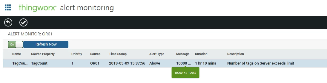

Manufacturing App has trouble getting the latest values from Kepware. It is updated in Kepware Quick client but not in Thingworx. Found an error in Controls Advisor "TagCountAboveLimit", I do have close to 20K tags. Is the limit 10k for control advisor? What to do if there are more tags than 10k due to large number of machines in one factory.

can you send an screenshot of the error please. Controls Advisor should not have a tag limit. How ever there is a performance limit for Thingworx to bind remote properties to one thing, depending on the server performance of Thingworx. It is also recommended to have split the tags inside kepware in different channels and not to bind everything to Thingworx if not necessary.

Here is the error I got. I have 19945 tags there but I only use about 30 tags to bind to properties. I am having problem where some key tag values are not updated. Some of the tags are 3,4 days old and not getting new value from Kepware. I checked Kepware using Quick Client; values there keep changing.
