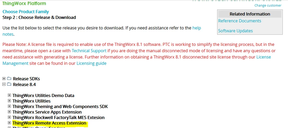

Hi @SaranKarthick.
What procedure are you using for accessing the downloads?  If you're linking to it from the Sales order, it may not show up.  Try these instructions:
  1. Navigate to PTC Support
  2. Select Download Software
  3. Select Order or Download Software Updates
  4. Select ThingWorx Platform
  5. Expand Release 8.4
Regards.
--Sharon

Jul 22, 2019 5:30 AM UTC
Thanks @slangley . I was searching under PTC Smart connected Products category.
Saran
