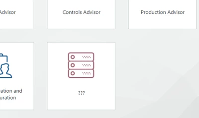

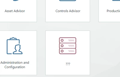

The tile is added to the Console linked to Controls mashup, but the label in the tile is not ok (shows ????) and when I open the controls mashup it seems to be not connected.

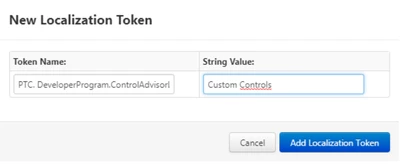

Hi @mariaaliceduart,
Thanks again for the detailed explanations. It looks like you may have an unintended space or <LF> in your text entry for "PTC.DeveloperProgram.ControlAdvisorLabel" between "PTC." and "Developer". This can happen sometimes when copying/pasting from the pdf instructions.
Can you try pasting the text into Notepad first, to validate it's correct, before pasting into the Localization Token in Mashup Builder?

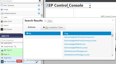

-Open Composer, open and edit any Mashup that contains a Label
-In the Widget browser, select a Label
-In the lower-left Widget Properties menu, locate the Localization field. Select the Globe icon to open the Localization table. Then create a New Localization token
-Enter the Token Name and String Value from Step 6 in the pdf.
After a Save and Refresh, you should find the App Icon is now called "Custom Controls". Do you find this is true?

I tried the Step 6 again.
Opened Composer, opened and edited Mashup KEP_ControlConsole.
Selected Label "KEP Control Console".
Selected the Globe icon to open the Localization table.
Saved and refreshed.

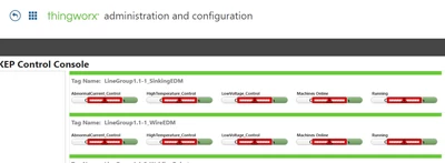

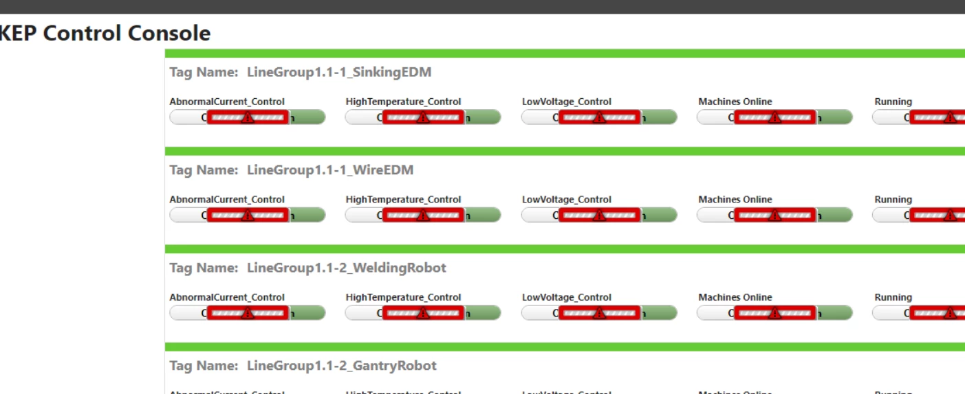

Still not working:Console.png
In Log, there is an error message:
[context: com.thingworx.webservices.context.HttpExecutionContext@4704cb5e][message: Execution error in service script [Controller ReadProperty] : Wrapped org.apache.http.conn.HttpHostConnectException: Connect to 127.0.0.1:39320 [/127.0.0.1] failed: Connection refused: connect Cause: Connect to 127.0.0.1:39320 [/127.0.0.1] failed: Connection refused: connect]
