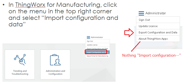

I downloaded it because I wanted to install [DemoFactory Package] in the environment where Express Install was done.
As I go through the instructions, there is no [Import configuration and data] in the [Administrator] menu in my environment.
What is the reason why I can not install?  Is it due to license or installation?

Greetings Takashi,
The Express installer do not give you the option to Import Configuration and Data .
The issue is not with your installation . Its just the limitation of the Express Installer. Refer to ThingWorx Manufacturing Apps Guide https://support.ptc.com/WCMS/files/173731/en/ThingWorxManufacturingAppsSetup_8-0-1.pdf ( Page No 7 - Understanding your Express or Developer Edition License )

Since my PC environment is internally unified in Thingworx Ver. 7.3, Ver. Up to 8.0 can not be done. For this reason, I use AWS to install Manufacturing Apps and try it.
After installing with Express Installer, I installed Extension,
There is no [Import configuration and data] in the [Administrator] menu in my environment.
Is not this way useless?

Greetings Takashi,
Express Installer does not provide option to import configuration and data .
For Manufacturing Apps, the required ThingWorx version is 8.0.1.  Using this version you can import the Manufacturing Apps Extensions and then you can go ahead and import the DemoFactoryPackage.
