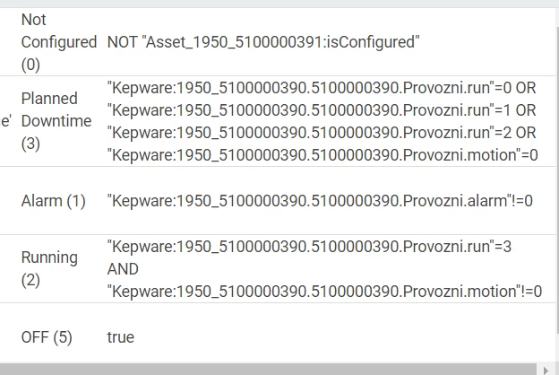

I have some troubles with Asset Advisor - Equipment Statuses
What is update period of Equipment statuses ? How MFG apps scan Expressions ? What exactly mean criticalyOrder ?
i have connect CNC machine to MFG via OPC but status not changing correctly. Sometimes It takes 2s, sometimes 20s and sometimes more than 1 minute. Sometimes when the expression changes in that time, status is not displayed at all (we have downtime for example 20s but status is still running)
Thank you

On the Status screen, the possible states for the equipment are defined. There are 6 states provided by default:
Not Configured, Planned Downtime, Warning, Running, Unplanned Downtime, and Unavailable.
Of these states, the expressions for Planned Downtime, Warning, Running, and Unplanned Downtime can be defined.
The status expressions are evaluated in the order that they appear in the table. The first expression to evaluate to true determines the state of the equipment.
You can change the order of the editable states using the and actions.Capture1.PNG
When equipment is first created, the Not Configured expression evaluates to true by default. The equipment remains in the Not Configured status until you have edited and saved the expression for at least one of the editable states, or have reordered the states.

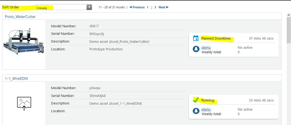

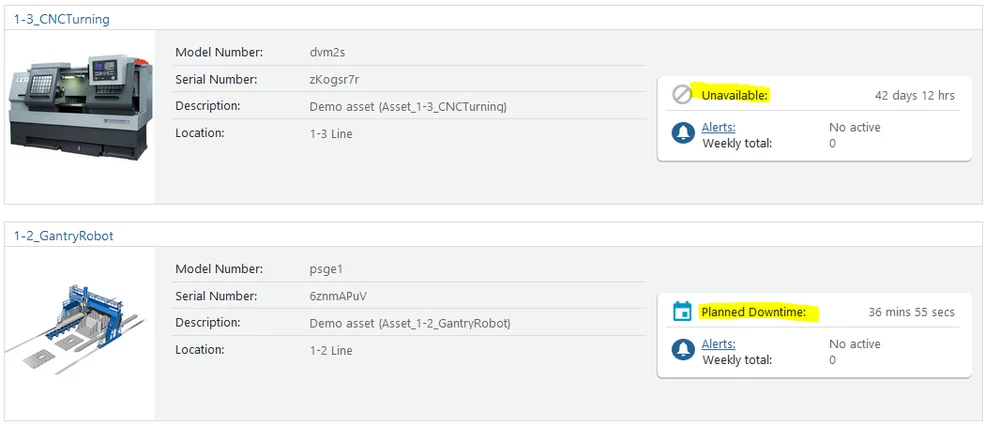

CriticalityOrder— is a required field when configuring the status. It sort the order for the status when sorting the Asset Advisor asset list by criticality. The higher the value, the higher the criticality. This value must be unique among the statuses applicable for a particular equipment type thing template or an individual equipment thing.
Let say value for criticalityOrder for status unavailable is 40, planned downtime= 30 and Running = 10 , then on Asset advisor page sort order by criticality fist is shows the assets which are unavailable then asset with planned downtime lastly assets which are running.
To further look into the issue why your status is not evaluated immediately/correctly we required  to investigate the kepware logs and application and communication logs. Additionally, which version of ThingWorx and Apps are you using?
