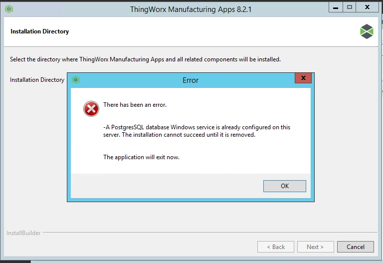

Hi all,
I downloaded Thingworx Manufacturing App 8.2.1 from developer portal. When I was trying to install, I got below error. I installed Thingworx 8.3.0, KepServer and PostgresSQL. I don't want to uninstall programs. Are there any workaround solution?
Best answer by slangley
Hi @burak.
Thank you for using our community.
The trial version of ThingWorx Manufacturing Apps is intended for customers who are evaluating use of the software in their environments, and has therefore been designed for ease of installation.   Since this version includes PostgreSQL, it will not install if a separate instance of PostgreSQL is detected on your system.  There is no workaround available short of removing the existing instance or installing on another machine.

22-Sapphire I
June 27, 2018
If you do decide to purchase the Manufacturing apps, there is a separate path to install the full version where you can install the apps into your existing Thingworx deployment
