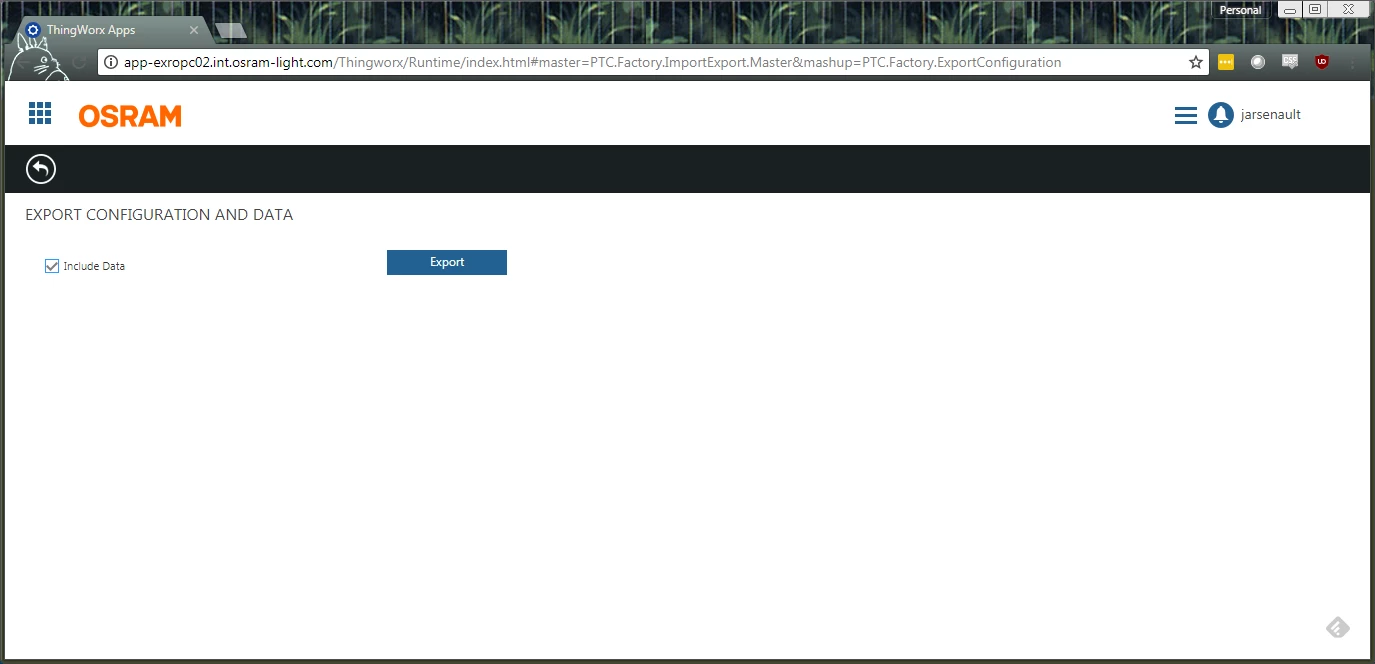

I'm receiving the following error when trying to export data and configuration from manufacturing apps in preparation of upgrading them to 8.3.
Error while processing task : com.thingworx.contentmanagement.DataExportProcessor.exportAllDataObjects
I've already upgraded the ThingWorx platform to 8.3 without issues, and I haven't been able to find any documentation on how to upgrade the manufacturing apps, so I want to cover all my bases with the data backup.

June 26, 2018
To reproduce I'm selecting the export configuration and data and selecting include data on the export screen.
then I'm clicking export.
image and application log attached

Hi @jarsenault89,
This error occurs in case when Manufacturing apps version is not compatible with ThingWorx Platform version.
Since you are using ThingWorx Platform version 8.3, you should use Manufacturing apps 8.3 version.
Import the compatible version of Manufacturing Apps to ThingWorx Platform version and then try to export data and configuration.
