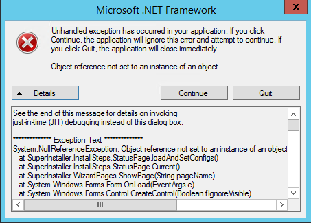

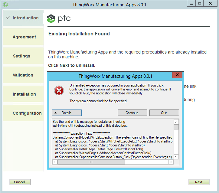

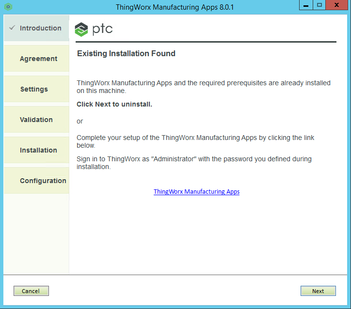

I had an earlier version of Manufacturing Apps installed. I downloaded the new version and tried to upgrade it. When I click the setup, I get an .NET Framework error, even though I've added the .NET Features and done the Windows Updates. After I click "Continue" I see the Installation pane but I get the error on the ss below constantly in every click. I clicked "Next" to unistall the earlier version but nothing happens? Do you have any ideas about this?

I never seen this error before. Can you try the following?
1. Restart your computer
2. Go to Windows features. Can you provide the screen shot? You will need both NET 3.5 and NET 4.x
3. If you have both, can you try running again?

It looks like you are upgrading the existing installation. The installer doesn't support the upgrade at this time. You should try uninstalling the existing version before reinstalling. You should able to export and import your data.

I had both NET 3.5 and NET 4.x installed but I removed and re-installed them. (It is not recommended to remove .NET features because it removes the GUI also on Server 2012 R2, I was not aware of this then.)
But these procedures seem to have no effect on the errors. Kinex is not listed on Programs and Features of Control Panel and I cannot use Manufacturing Apps to uninstall. How do I uninstall earlier version?

Thank you for confirming the path you took to resolve your original question. Other users with a similar question, please note, the Mfg Apps Express and Dev Kit uninstall application can be found here:
<Install path>\ThingWorx Manufacturing Apps
For a separate discussion of this, including screenshots, see this thread:
I'm looking for uninstall.exe (for uninstallation).
